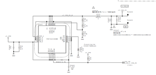

    Our system does not use soft start. Vin = 3.3V input.
    In that case, IN and BIAS are directly connected, and EN is pulled up with 4.7 kΩ with respect to Vin.
    The reason is that the power is not turned on before IN and BIAS.
    The data sheet confirms 7.5.2 Sequencing Requirements.
    Our circuit diagram is attached.
    C3458 and C3462 are not implemented.
    Please pointed out if there is a problem.
    Yoda
  • Hi Yoda,
    Thank you for sharing your schematic.
    Is the content you should be concerned about in the answer about 7.3.1 Enable, Shutdown in the TPS74401 data sheet?
    Yes, that is what I have been referring to.
    I went and read your original thread for TUSB7320, and I noticed you mentioned that the oscillations occurred
    "About once when the power is turned on 30 times"
    Do you mean this started to occur after 30 times of power on the system?
    I asked around the office, and reviewed the first schematic you showed me, and it looks fine. The Css, as discussed, is used for the Soft Start,
    and it will help on the PSRR and to reduce some noise coming into the LDO, however, it is not a requirement.

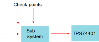

    Also, is it possible you can show scope shots of Vin, Vbias, and Vout for the TPS74401?
    Lastly, can you do an A-B-A swap? if not, can you remove the LDO from the board and test it by itself?
    Edgar Acosta

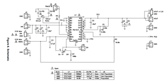

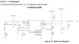

  • Is C3462 needed for EN pin?
    Brian
  • Hi Brian,
    Not necessarily. I see that it is being used in the TUSB7320 design reference, but it is not a requirement. Below is a schematic of the EVM designed for TPS74401 as a reference as well.

  • it showed up on both input and output
  • Hi Brian,
    There could be something else in the system causing the oscillation, thus appearing at the output of the LDO. I would suggest to trace the signal and verify the origin of the oscillation prior the LDO.
    Edgar Acosta
