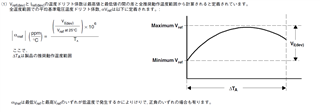

I wanna confirm the temperature characteristic of VREF (reference voltage) of TL431BIPK.
How much does the voltage of VREF change when the operating temperature changes from -40C to 70C?
Based on the calculation formula of the data sheet (Pls see attached),
Vi(dev)=34mV、Vref=2.495V、TA=125℃(=85℃-(-40℃))
|αvref|=1.09×10^-4%/℃
The voltage Deviation when changed from -40C to 70C, I think it's 2.495×(70℃-(-40℃))×αvef =29.92mV.
is it correct?
