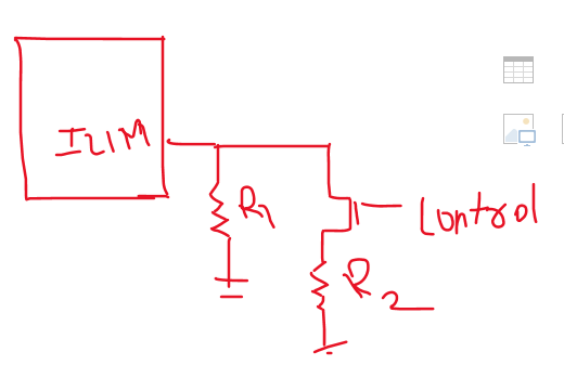

    1. How much charge time do you want ? You can choose large dvdt cap but then charge time will be in seconds.

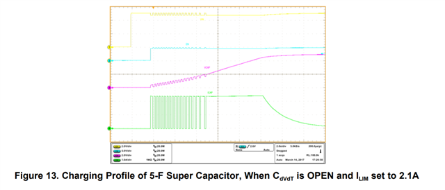

    2. Also you can start device in current limit. What you can do is set current limit to lowest during startup and make dvdt=open. This make device turn on in current limit and you will see thermal shutdown happening but also charging will happen if you set device for auto retry response. But we cannot calculate charge time here. After startup you can change current limit back to steady state value of 5A. You can try this on our EVM.
    This is example image for TPS25940 efuse:

    2. I can use auto retry response. How can I switch between I_lim during startup and steady state?
  • Hi Christopher,
    1. It is happening because Rlstart field will be at low value. Make it to high value in megaohms. Please try testing with cdvdt cap greater than 2.5uf.
    2. This is the way you can change current limit.
