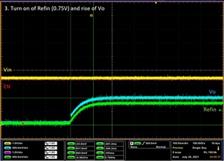

    Can you provide waveform of REFOUT and VO to see if there is anything abnormal on the waveforms? If these waveforms are stable, they should follow REFIN. So we really need waveform to check if there is issue.
    Weidong

    About your recommend of the waveform check, we can not provide and can not check the waveform right now.
    But our problem situation is that REFOUT voltage did not follow with REFIN voltage.
    When 0.75V volatge forced to REFIN, but REFOUT voltage is 1.05V, actually.
    We think about this problem wight be occurred by input voltage sequence.
    We think that our voltage input sequence would set as prohibit sequence and would  damage to the device.

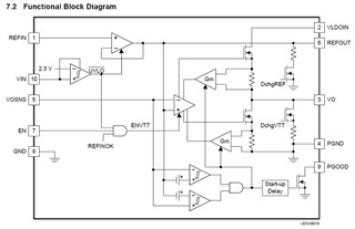

  • Hi Kura,
    Regarding power up sequence, VIN has to come up earlier than REFIN, please refer to figure 19 and figure 20 for recommended power sequence. If REFIN is up before VIN, the internal state is not determined because lack of bias voltage, so it's possible to cause issue.
    Weidong

  • Hi Kura,
    For additional question #1, it's possible that REFOUT and VO is higher than REFIN, but most of the time it's because TPS51200 is sinking current (meaning current is flowing from load to TPS51200). You can referring to figure 10 and figure 15 in datasheet.
    For additional question #2, if REFIN is open, then there will be no reference voltage to generate REFOUT and VO, so the part will not have output voltage and will not be functioning. So it's definitely not a recommended operation condition.
    Weidong
  • Hi Kura,
    If you pull VO to -0.7V with external power supply, and TPS51200 wants to pull it to 0.75V, then two power supply will fight for each other and the stronger one will win. I don't know what's the current capability of the external power supply, but TPS51200 does have current limit ~4A. So if the external power supply is stronger then VO will be pulled down, and VOSNS pin will follow. But in a normal case REFOUT should still follow REFIN. If VO is 0V, it the situation will be similar, VO might be pulled to a negative voltage by the external power supply.
    Weidong

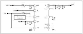

  • Hi Weidong
    Sorry for late reply.
    I would like to answer about your two questions below.
      (Q1) For step 2, how did you make the REFIN pin open?
      (A1) The external power supply was connected to REFIN at TPS51200 device function check due to forcing voltage.
             But when REFIN pin would be OPEN, the connection with external power supply would be cut off.
      (Q2) Providing the schematic,
      (A2) We explain the pin situation of TPS51200 device in our circuit as next.
              We would like you to understand our circuit from this explanation, and we hope this explanation would be helpful to know the schematics difference of yours.
           *REFIN : It has 10k ohm resistor and has pull-down with 10000pf.
                          R2 in your circuit is not set in our circuit.
                          There is the reason why the R2 did not set in our circuit due to the special designation.
           *EN : The power supply is connect directly.
                     It is same pin situation as your circuit.
           *PGOOD : It is connected to VIN pin, and it has 100k ohm resistor after connection point.
                            There is expernal terminal to measure the PGOOD voltage.
                            It seems that it is same pin situation as your circuit.
           *VIN : It is connected to PGGOD pin, and it has pull-down with 4.7uF after connection point.
           *VLDOIN: It has pull-down with two 10uF.
           *VOSENS: It is connect to VO directly.
           *REFOUT: It has pull-down with 0.1uF.
                            There is no connection REFOUT pin, there is only pll-down.
           *PGND : It is connect to GND directly.
           *VO : It has pull-down with three 0.1uF that it is outside from connect point with VOSNS.
    If you could not imagine about our circuit from this explanation, please let me know.
    We would like to know the mechanizm of the VO=VOSNS=REFOUT<REFIN situation.
    The VO=VOSNS=REFOUT<REFIN situation would be reason that PS51200QDRCRQ1 device internal circuit had been damaged, isn't it ?
    Thank you for your support as usual.
    Beat regards,
    Kura

  • Hi Weidong
    Sorry long time no reply to you.
    We get the waveform picture about VO=VOSNS=REFOUT>REFIN situation.
    We can show 3 pictures.
    1st: After measurement setup, the picture shows at turn on of VIN.
            By measurement setup, EN,REFIN are connected to GND at external power supply internally.
            (= External power supply is not be forceing any voltage yet.)
    2nd: The picture shows at turn on of EN after VIN turned on.
            EN,REFIN would be connected to GND at external power supply internally.
            By measurement setup, REFIN is connected to GND at external power supply internally.
            And VIN voltage has been kept 3.3V by external power supply.
    3rd: The picture shows at turn on of REFIN after EN turned on.
            And the picture also shows that VO level(= about 1V) is higher than REFIN(=0.75V).
            VIN,EN voltage have been kept 3.3V by external power supply.
             VO is out at the timing of REFIN voltage forcing, but voltage level is different from REFIN.
            It should be same.
    Is there any abnormality about those pictures ?
    If you have any comment about that, please let us know.

    Thank you for your prompt reply.
    Our information is not correct about capacitance on the VO output.
    That is not 3x0.1uF, but 3x10uf.
      (* Could you please refer to next circuit figure.)
    Our capacitance on the VO output is same as TI recommendation in the Datasheet.
    So we do not think the VO=VOSNS=REFOUT>REFIN situation is caused by the VO output capacitance.
    And then, we would like to confirm whether VO=VOSNS=REFOUT>REFIN would be caused by REFIN=OPEN, or not.
    Your comment is "REFIN=OPEN is not a valid operation and the device is undetermined under this case. ".
      (Q1) Is REFIN=OPEN situation forbidden due to undetermined REFIN input ?
      (Q2) Is there any possibility device would be broken by undetermined REFIN input by REFIN=OPEN ?
      (Q3) If device would be broken by undetermined REFIN input, where is damaged at device internal circuit of next diagram ?
    Thank you very much for your support.

    And we have one more question about characteristics of our failure sample, strange phenomenon is observed.
    According to following description in the datasheet, TPS51200 has characteristic that REFOUT voltage shows 0v at REFIN<0.39V condition.
    However, when REFOUT voltage is over 0.39V REFOUT voltage begin to follow with REFIN voltage.
    <The description in the datasheet>
    7.3.12 REFOUT (VREF) Consideration for DDR2 Applications
    During TPS51200 tracking start-up, the REFIN voltage follows the rise of the VDDQ rail
    through a voltage divider, and REFOUT (VREF) follows REFIN once the REFIN voltage is
    greater than 0.39 V.
    When the REFIN voltage is lower than 0.39 V, VREF is 0 V.
    Our failure samples show VO=VOSNS=REFOUT>REFIN phenomena that VO=VOSNS=REFOUT voltage shows about 1V at REFIN=0.75V condition.
    It seems that VO=VOSNS=REFOUT voltage is out with 0.25v offset from REFIN voltage.
    We could confirm strange characteristic that our failure samples show when REFOUT voltage is over 0.15V REFOUT voltage begin to follow with REFIN voltage.
    According to the datasheet, it should be over 0.39V about following REFOUT voltage with REFIN characteristic.
    However our failure sample is about 0.25V offset from datasheet characteristic.
    We have checked also our good sample shows same characteristic of datasheet, when REFOUT voltage is over 0.39V REFOUT voltage begin to follow with REFIN voltage.
    So we think, our failure sample's strange phenomenon that has offset about REFIN=REFOUT voltage start might be the key to find the cause of out failure.
    We would like TI to give TI's consideration about strange phenomenon mechanism.
    We would like to know what internal instruments would not be work correctly to do strange phenomenon reproduction.
    For example, a sample of the strange phenomenon is which FET in the following block diagram is not working properly?
    Would you please to do PFA about our failure samplse, and to give the comment about TI's consideration about strange phenomenon mechanism.
    Thank you very much for your help.
    Beast regards,
    Kura
    Would you please give the comment about TI's consideration about above strange phenomenon mechanism.
    Beast regards,
    Kura

    So, we would like you to point out where would be damaged internally in next Block Diagram which is in the Datasheet.
    Would you please again give the more detail comment about TI's consideration about above strange phenomenon mechanism.
    Beast regards,
    Kura
  • HI
    Sorry. We can not provide a FA on the part from non-authorized distributor per TI legal agreement.
    The suspicion is on the FET next to the REFOUT, but we can not confirm.
