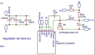

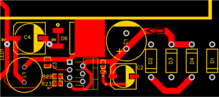

Hi there!
I'm designing a buck converter that converts the voltage around 20v-40v to 5.5v at 3.5A.

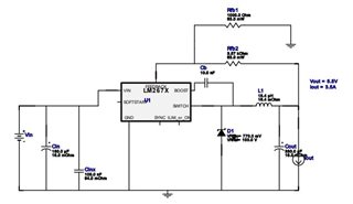

I followed the WEBench guides, but I don't know exactly what's wrong with my design, below are pictures of the circuit.
I believe that the main problem is in the pin on/off, but I believe that it is not just this error.
Webench
My desing
