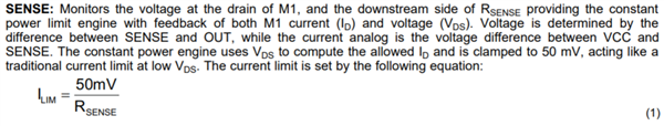

For current limit, I refer EQ1 from datasheet page.7. For Rsense is 22m ohm, the ILM is 2.27A
But the GATE turned off when input current reach 2.86A. It's different of the value of calculation(2.27A).
Could you help to explain about this issue.
ILM = 50mV/22m ohm
        = 2.27A

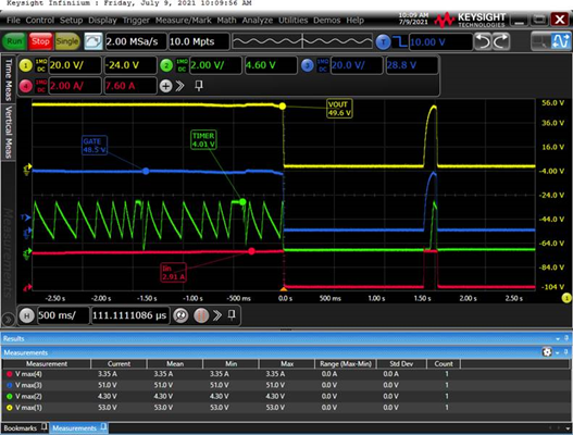

The waveform as below:
Ch1 : Iin
CH2 : GATE
Ch3 : Vcc
CH4 : Vo

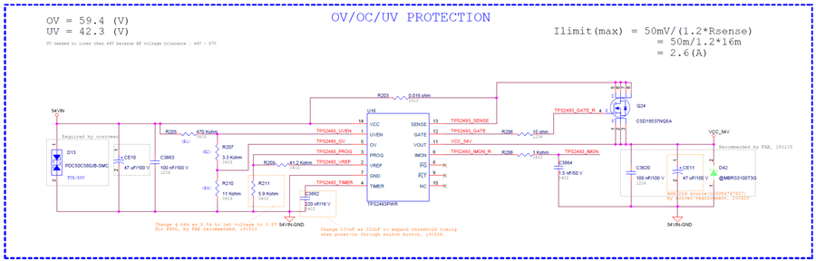

The schematic as below:

  • Hi Denny,
    What is the test condition for that test waveform ? Is it during Vin power-down?
    Can you please share better resolution schematic image.
    Rakesh
  • Hi Rakesh
    The schematic image as below.

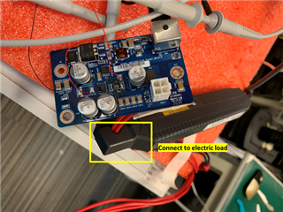

    Test condition :
    Rsense is 22mohm Result.
    Connect to electric load.
    sink load at Initial current 2.5A and Vin power-down when current up to 2.8A(slowly load on from 2.5A)

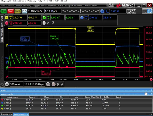

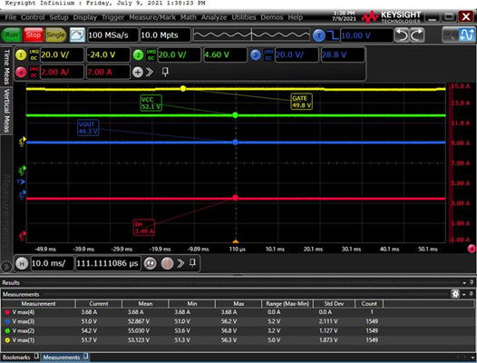

  • Hi Rakesh
    The test waveforms as below, could you help to recommend?
    Vin, GATE, Timer, Input current
    Vout, GATE, Timer, Input current
    This experiment is to change Vin to be supplied by dc power supply instead of PSA , and it will not OCP if electric load sink 3.5A.

  • Hi Denny,
    Thanks for the test waveforms..
    Couple of observations.
    1. Timer waveform and pattern looks very odd.
    2. GATE and Vout are at same level.. means FET is OFF but the question is why Vout is not dropping ?
    Have you tested at no-load ?
    Use resistive load for testing. Some electronic load behave weird during fault modes.
