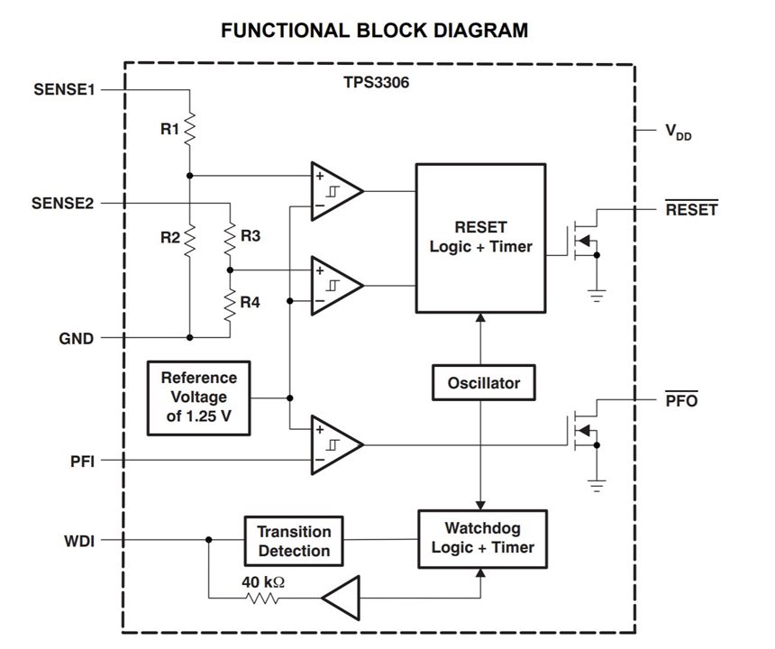

I am using TPS3306 for monitoring 3.3V and 1.8V.
I am using external resistor divider at pin SENSE1(3.07V), and SENSE2(1.76V) to setup the threshold.
In the datasheet there are internal resistors R1, R2, R3 and R4 used at the  non inverting terminal of internal comparators as shown below.I need to know the value of these internal resistors with tolerance
Please help with your input.
