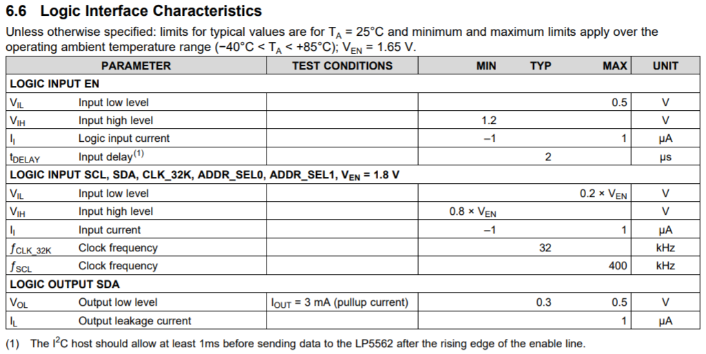

3. From Figure 18. The input level of Pin  EN/VCC determines the Digital IO input level (I2C, CLK_32K, ADDR_SEL0, ADDR_SEL1)?

    For Q3: Refer  to the chapter 6.6 Logic interface characteristics.

  • Hi Monet
    1. Refer from chapter 6.6, If VEN=3.3V and the input level of (I2C, CLK_32K, ADDR_SEL0, ADDR_SEL1) will change to 3.3V?VIL=0.66 and VIH = 2.64?
    Condition :
    VEN=3.3V
    VIL= 3.3*0.2=0.66V
    VIH=3.3*0.8=2.64V

  • Hi Denny,
    For question 1
    Yes, the input level will change with the voltage of VEN
