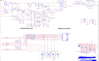

Dear Team
Could you please help to review customer's layout?
The layout file as attachment.
POE_V00_20210706b.brd
Many thanks
Denny

  • Hey Denny,
    Here are some comments on the layout:
    - D29 needs to be as close to the IC as possible. it should  also have at least two vias per pad
    - the input power path is not optimized. The IC is on the opposite side of the board as the input. This is not preferred power path. The IC should be on the side of the transformer as the RJ45 input. We do want the IC pin DRAIN to be as close to the transformer as possible to minimize this  path. It appears this is done. But we must also work to reduce the input power path in general.
    - the input bulk cap should be closer to the IC as well.
    - the drain path is too narrow. The entire primary side current is flowing through this trace, it should be bigger.
    - Both RSNS resistors should have more vias

  • Hi Michael
    Thanks you recommend, the customer will modify from your suggest.
    - How width could support the current?
    For Vin= 48V、P=13W、I=P/V=0.27A
    1. For 802.3at standard : power go though 2 pair.one pair is 0.135A?
    2. The width of every trace just support 0.135A is enough? is 10oz 1mil ok?
    Many thanks
    Denny
  • Hey Denny,
    Great question.
    In the EVM, we use 30mils for this power stage. In higher power, we use wider traces.

  • Hi Michael
    Thanks your recommend.
    The customer already modified the layout. Could you help to review?
    POE_V00_20210720.brd
    Many thanks
    Denny
  • Hey Denny,
    I reviewed these changes and they look good. Thank you!
