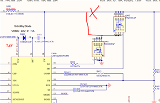

Hi Sirs,
My customer is developing a board for LM5122 for 12V-in to 13V-out with 10A output current. (Vin_min is 11.5V, Vin_max is 12.5V)
Could you please help to check and advise the schematic?
Thanks for your support.

Hi Sir,
My customer follows your comments to modify the schematics, could you please help to review it again?
About L6, use the CMLB177T-2R2MS the DCR is lower, and can get the better thermal performance. so this base on your thermal condition.

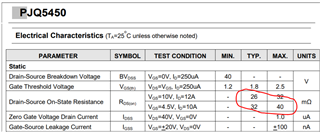

PJQ5450 Rdson is too big , advice change Rdson lower than 10m0hm, of cause this is also base on your thermal condition.
