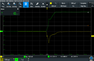

I pull the EN pin high for around 80us then low  then high again until reaching the nominal output (4V).
This method seems to be working well.
On the graph below green is TPS61021A  output and yellow the voltage drop on the battery. Voltage drop is limited to around 100mV compared to around 350mV with a regular startup.

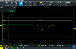

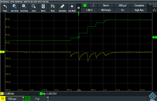

  • Hello Wenhao,
    Thanks for your reply.
    Following your advice I added more input capacitance and improved the external SS circuitry.
    This allows to reduce the drop to around 200 mV without using the first method ( yellow is voltage drop on battery and green is TPS61021A output):
    200mV is still a bit high but almost acceptable.
    So I also implemented the first method to decrease the voltage drop due to the pre-charge phase. I understood it's not fully reliable because delay between EN high and regulation is unspecified but the method can't be harmfull. At worst the precharge phase is unchanged.
