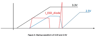

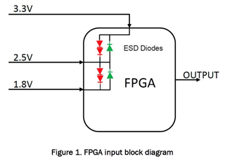

Would like to know what is the typical power sequence of processor power rails? I mean below three:
Coincident tracking, Ratiometric tracking, Sequential.
As you know there're ESD diodes inside between different rails, if sequential is used like below, it has risks of ESD diode burnt.
