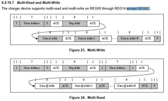

Hi Team,
According to the DS, it seems that the customer can't use multi-read on REG0C.
Any idea what will be the result of REG0C if the customer used multi-read to read back all the registers after reset?
Will the device report from REG00 to REG14, but ignore REG0C register? Such as REG0B->REG0D->REG0E.
Or if the fault event is cleared when the EC read REG0C with the multi-read, the value of REG0C won't clear. Thus EC had to use single read to REG0C for the second time and the third time to clear the fault event.
