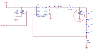

I would like to drive 4 of LED(VF 2V, IF 1.5A) by TPS92200.
Could you check design of schematic?
L=6.8uH, COUT=10uF, RSENSE=66mohm
Also I worry about COUT value.
because I didn't know how to calculation of The dynamic resistance of this LED(RLED).
Could you teach me it?
