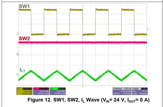

    The figure below is the official data sheet of lm5175. The first item is whether I can think that there is tens of ma current when no-load. Is this normal? So lm5176 should also have this current. How much is the no-load current?

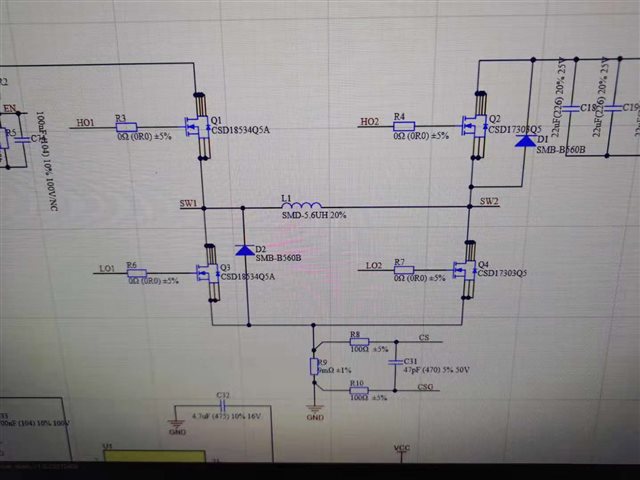

    I tested the input of 24 VDC and output of 12 V without any load. At this time, the input current is about 40 ma.As shown in the figure below, it is the bridge arm part.

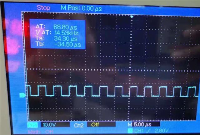

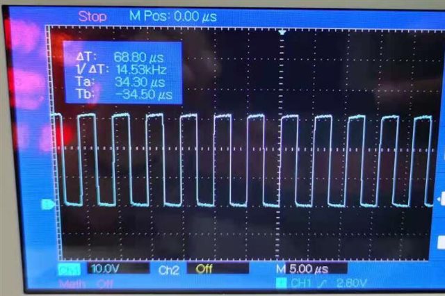

    As shown in the figure below, it is Q1 waveform
    As shown in the figure below, it is Q3 waveform

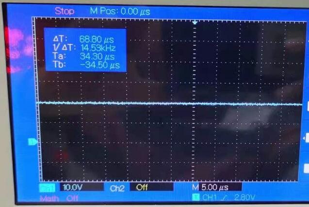

    As shown in the figure below, it is Q2 waveform
    Q4 off.Lm5176 works in Buck mode.As shown in the figure below is the reference waveform of snvu547. The above waveform is the same as this one. So I think work is normal.
