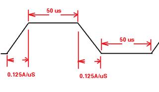

We have an 802.3at PD design by using LM5072-80. The design is a flyback design with output of 12V/2A.
It is working well with small output ripple (< 60mV)  in static load. However, the output ripple is large than
1V when the PD is loaded with an Electronic Loader which was setting with fast transient (125mA/us).
The PD has been equipped with a "LC low pass filter" at output port.
Is there any way to reduce the output ripple for dynamic load? Is this large ripple related to poor bandwidth,
or it is unstable at fast load transient? Should I fine tune voltage compensation loop?

  • Hi Michael,
    Thanks for your reply. We tried to use electrolytic capacitor (330uF/25V) from different venders,
    and we got different results. The C7 from one of vender, have larger ripple (220mV) @12V/2A static load,
    yet it has smaller ripple (550mV) @12V/2A dynamic load. The setting of dynamic load is shown in
    my original question. However, the C7 from other venders, have smaller ripple (60mV) @12V/2A static load,
    and they cause larger ripple (1.83V) @12V/2A dynamic load.
    Is the large output ripple caused from closed loop stability? If so, the ripple may be able to be improved
    by fine tuning type-II compensation. Should I increase the value of R18 or C18  in order to decrease the zero of compensation loop? Or, it is because of slow output transient response (Bandwidth too small)?
    Besides, the electrolytic capacitor C7 (330uF/25V ) is located in front of output LC filter,
    I am not sure if it plays the role of output capacitor or not? Nevertheless, its ESR seems to affect the output ripple. The output capacitor C9 (10uF) is a MLCC, so it has low ESR.  Nevertheless, its output ripple @dynamic load is unacceptable.
