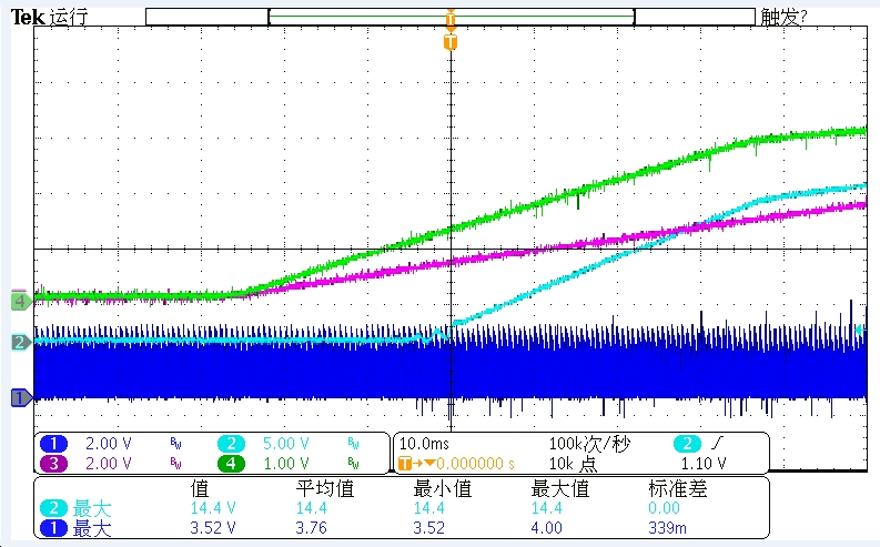

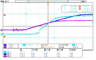

  • Dear Hong
    See the following waveforms: the first is the output monotonic waveform, the second is the non-monotonic waveform,
    the blue is the output, the purple is the SS pin, the green is the COMP pin.
    Attached full schemetic:
    CD110T170.pdf
    It looks on your non-monotonic Vout capture, COMP and SS have a long overlap, meaning, the control is switching back and forth between SS and COMP, mainly due to the noise on each signal, SS or COMP. As noise level and characteristics can be different on SS and on COMP, the control will generate different pulse widths, then cause Vout non monotonic shape. It looks you need either do the fast SS like your monotonic or change COMP ramp so to avoid long overlap between COMP and SS.

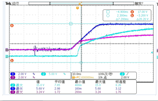

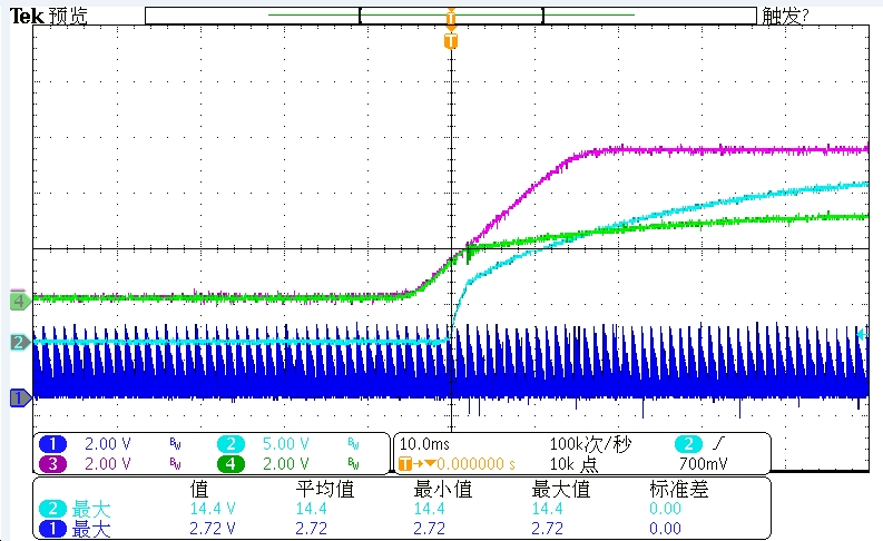

  • Dear Huang Hong
    When the output waveform is monotonous and non-monotonous, the overlap time of the waveforms of COMP and SS pins is indeed different. However, in the non-monotonous region, SS and COMP are overlapped. This cannot be clearly explained because the slow soft start causes the output to be non-monotonous.
    See the following waveforms. The first one is the monotonic waveform, and the second chapter is the non-monotonic waveform, CH1:SS, CH2: VOUT, CH3:COMP.
    You need to zoom in the overlap area to make analysis to decide which signal is in control. The noise from two signals is not the same so if the control back and forth the PWM will follow and possible with pulse width not always increase. But these need to zoom in that overlap to check. Your current resolution cannot find these details.
