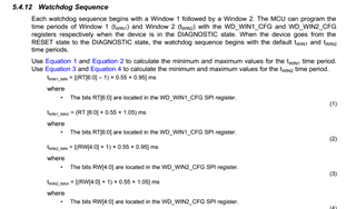

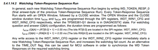

 I found the paper of TPS65381A  ,dont have the open time and close time calculation way.only have the max and min time. in 5.4.12
and the paper of TPS65381, have the open time and close time calculation way. They are very different
please tell the TPS65381A  calculation way.I hope to see evidence
