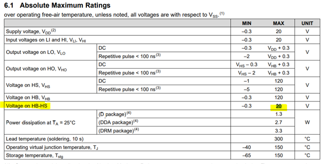

Hello Team,
I have a question on HB-HS max raings of UCC27201 and UCC27201A.
I checked from other e2e thread that the only difference between UCC27201 and UCC27201A is the HS spec from -5Vmin to -18Vmin.
But there's one more difference, HB-HS spec, from 20Vmax to 120Vmax.
Could you confirm if it's just a typo or if UCC27201A has a completely different internal driving circuitry?
<UCC27201>
<UCC27201A>
