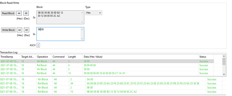

  4. Is there a way to capture the Transaction Log from ‘Adv Comm SMB’ tab in bqStudio
Detail regarding AFE_VCELL (sub-command 0x5A), using bqStudio Adv Comm SMB tab:
Write Block to 0x44:  0x5A 0x00
Read Block to 0x44: 5A 00 E8 25 EF 25 ED 25 F4 25 E8 25 EC 25 F1 25 F0 25 EB 25 EC 25 E8 25 ED 25 F8 25 F8 25 E9 25 3C 8E

For Reference: Capture of All VFE related data (bqStudio Adv Comm SMB tab):
