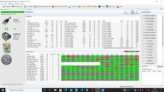

  • Thank you, I will enable the EDV_CMP bit, set the designed capacity and FCC before logging the discharge data.
    What happens if we don't set the EDV_CMP bit before logging and use these logged files to generate coefficients? Because I have a 2 pairs of  logged files(at 2 different temperature) in which EDV_CMP was not set. Can I use these files to generate Coefficients.
    Above is the Screenshot of the Current SOC indicated on Bqstudio.
  • The EDV_CMP bit is not important for collecting the logs. The important information from the logs is the voltage, current, and temperature. The GPCCEDV tool will recommend CEDV parameters based on your settings. After you have finished this process, then you can set the EDV_CMP bit and program your CEDV parameters to the gauge.
