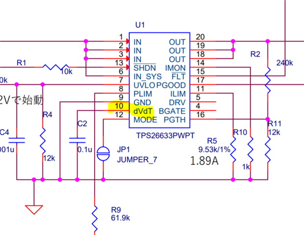

TPS2663: The dVdT slew rate cannot be adjusted.
Part Number: TPS2663
Other Parts Discussed in Thread: TPS16630-32EVM
Hi Team,
Please help the customer about the  tdVdT calculation. The test result is not meet the Equation 2 and Figure 9-1. Hot Plug In and Inrush Current Control at 24-V Input On Page 18 of the datasheet.
datasheet: www.ti.com/.../tps2663.pdf
Please refer to the details attached.  And the customer would provide more details if needed here.

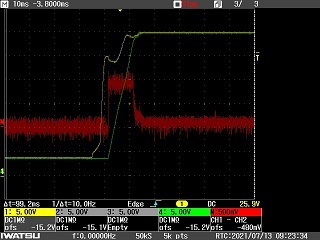

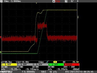

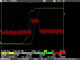

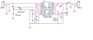

CdVdT is 0.1uF, but tdVdT is about 500usec.
The output capacity is 25uF.
