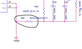

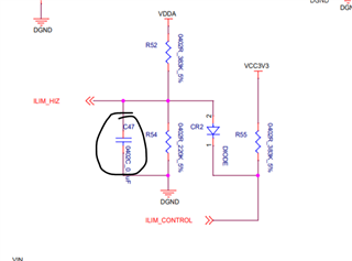

Hi Team
My customers has a SCH need you review, please help him
4760.BAT.pdf

    3. I think they can use a smaller capacitance for C47. Such as 100 pF like on the EVM.

    9. I find it weird to have a thermistor here? The EVM has a net-tie, but that is essentially just a copper wire.
    So I do see that they referenced the EVM quite a bit(not to say it is bad), but I would tailor the schematic for their own applications and only referenced the necessary parts. For example, CELL_CONTROL mosfet circuit may not be necessary in a production design.
