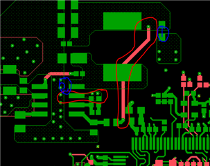

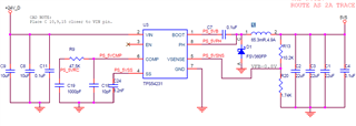

We are using TPS54231DR in our design as step down converter with the following specifications,
VIN = 24V
VOUT = 5.5V
IOUT = 250 mA
We are powering the board from DC SMPS power supply.
I am here with attaching the the image of schematics and layout of the particular section.
Also attaching the some wave forms.
I compared our design with reference design, and found some mismatches. They are listed below,
1.It is not recommended to draw the feedback line under the Inductor.
2.Connect the GND pin to a strong ground plane with multiple vias under or nearby the die. ,since it is the heat dissipating pin of the IC. we connected using only two     vias with the ground plane in other layers.
Are the above two reasons lead to the damage of the IC during its power up?
3. The inductor used in our schematic (IHLP3232DZER150M11) have DCR 61m.
4. The EN pin of the IC is in floating stage , so glitches are formed during power off.

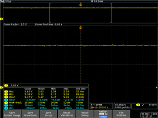

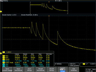

wave forms

    3. I reviewed the schematic and layout, but I don't think the 2 reasons you mentioned will cause IC damaged.
    4. Could you measure some waveforms on the good board? Including Vout, PH, and inductor current.
    Test conditions includes power on/off and steady state.
