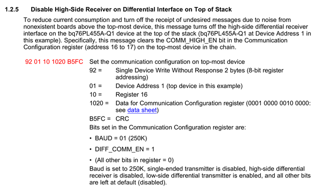

I am testing the Auto-Addressing procedure from the "SLVA617A–November 2014–Revised May 2015" document. I am performing the tests on 2 serially connected BQ76PL455A-Q1 based devices. My problem is that the second device is not always recognized after the wake up. I cannot find any reason for that. What I have noticed is that after I power recycle the 1st module (the one connected to the master MCU) and redo the procedure, both slaves are discovered correctly, so the problem lies somewhere within the 1st module.
What are the common problems when designing this part? I would appreciate all feedback.

    I am using both custom HW and SW on the master side. For your request I will need a while to hook up the scope- I understand you need me to attach the probes at the input of the second device (between the caps and the IC pins)?
    In the meanwhile, I have noticed the following: So far I have been always recognizing 2 devices correctly after removing this step:
    "1.2.5 Disable High-Side Receiver on Differential Interface on Top of Stack".
    This I have checked on the scope and the data I send is the same as in the given example:
    In theory, it should disable the high side interface for the second slave. Since nothing is behind it, there should be no issues...

    I am disaing the high side comm in the top module just because it is suggested in the doc. I have noticed that this step is causing issues only later.
  • Hi Lukasz,
    Ok, in that case ensure you are disabling the topmost device rather than one in the middle which could cause an issue.
    Taylor
  • This is something I though maybe happened. I have 2 slaves connected, my by error during the development it was only the 1st one who was discovered and the high side communication was disabled for him. For a while now I have added a routine that disables the high side communication in the last slave only, if the discovered amount of slaves is equal to the expected one. During 2 days of tests, I have not experienced invalid discovery issues, so it must be related.

    Best practice would be to perform a COMM_CLEAR and then a WAKEUP across the stack, then re-autoaddress to attempt recovery of communications. Take a look at section 7.3.9.6 of the datasheet for communications timeout details as I think it supports what you need.
