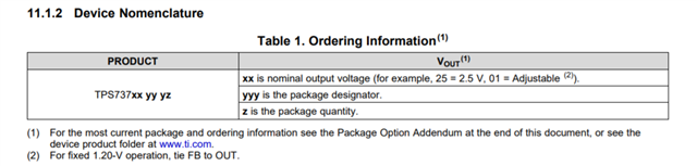

The output is fixed and with an output voltage of 1.9V.
Here is the nomenclature of the device naming.
