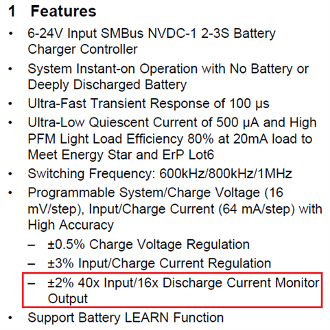

From the datasheet of BQ24715 I learned that it has discharge current monitor output function, so I was wondering how it monitor the discharge power consumption and system power consumption?
Best Regards
       You can monitor IOUT as charge current or discharge current depending on bit set in ChargeOption() bit[4]. Refer to section 8.4.7 as well as register table description for ChargeOption().

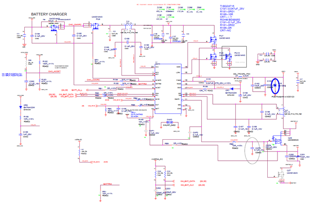

    But according to section 8.4.7 of the datasheet, we try to set the ChargerOption (0x12) to two values of 0x664E and 0x6646 and read the voltage of the IOUT pin (pin 7). The measured voltage values are as follows:
    1) Setting ChargerOption (0x12) to 0x664E, the voltage of IOUT pin is 0V.
    2) Setting ChargerOption (0x12) to 0x6646, the voltage of IOUT pin is about 0.2V.
    Can I know the cause of this problem? Or can u give some suggestion for this?
    My diagram schematic is as follows:
    Best Regards

    Now I have a new question, that is, considering the cost, we want to remove the n-channel power MOSFETs between adapter and BQ24715 (PQ5) in my schematic. I was wondering whether this is feasible?
    Kind Regards
  • Hi Lumina,
       For IOUT questions you can refer to this post where a similar question was asked previously: https://e2e.ti.com/support/power-management-group/power-management/f/power-management-forum/921913/bq24715-adapter-current-battery-discharge-current-using-iout?tisearch=e2e-sitesearch&keymatch=BQ24715%2520IOUT#
    Yes, you can remove one of the NFET (the one whose body diode cathode is at the adapter). This helps control inrush current on adapter plug in, but is not essential.
    The essential NFET required is the one whose body diode anode is at the adapter as this provides reverse voltage protection.
