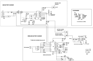

I used the circuit as shown in attached schematic .
It uses BQ24074 for USB charging
BQ51050B for wireless charging
BQ27421 as Fuel Gauge
We use Li- ION 4.2V / 1200mAh battery

(screen dump of schematic is shared here) Happy to share the full schematic if you could send me a message with app engr contact please
    I can help debug the charger portion.
    Would you be able to provide a high resolution photo? Please do not copy and paste the schematic but rather go attach the image through the INSERT > Image/Video/file option. Based on the behavior you've described it sounds like the device could have the safety timers expiring. This would cause the oscillation in the /CHG pin. Are you able to provide a data log of voltage and charge current over time for the battery?
