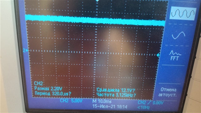

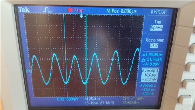

2. In our desing we set 12V Vin and 12V Vout.
Sometimes after OE Vout has ripple.
If set Vout=0.1V, then set 12V it seems it work fine.

B. Second case: ripple on Vout and high power consumption (~ 4 Wt), heating IC and L, result - bad work:

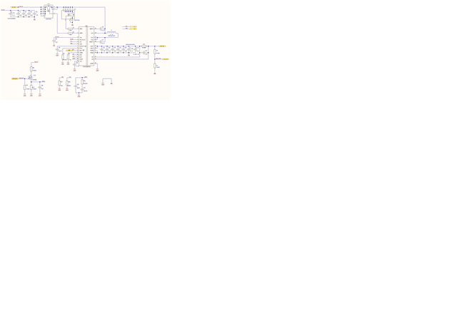

Please share the full schematic and layout first. In most cases the issue is related to the schematic and layout.
Could you share the waveform when you said Vout has ripple? What kind of ripple do you mean?

Hi Nick,
Yes you have to carefully tune the compensation parameters to make sure the circuit phase margin is higher than 45 degrees.
And CDC resistor R17 should be higher than 20kohm. The device doesn't support a 0ohm CDC resistor. If you don't need cable voltage droop compensation, leave this CDC pin floating.
