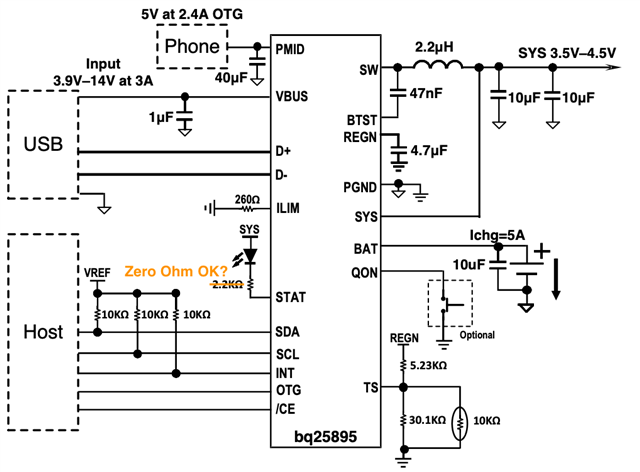

BQ25895: STAT Pin current-limited?
Part Number: BQ25895
Dear support team,
I want to use the STAT pin for charging indication of my device by connecting it to a LED like suggested in your reference designs, through, I need its luminous intensity to be as high as possible.
Now I need to choose an adequate current limiting resistor.
In Absolute Maximum Ratings it is stated that the max. Output Sink Current of the STAT pin is 6mA, but there is no information about the max. current under short-circuit condition.
Will the IC be damaged if I connect the LED without any current limiting resistor to 3V3?
