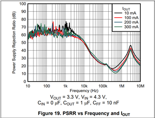

    I think first we need to identify the source of the ringing. How is the +12V supply generated? The datasheet says that at 200kHz the TPS7A25 should have about 20dB of PSRR and the customer is seeing about 26dB. If the excitation was coming from the output of the LDO (i.e. from an inductive spike) the ringing would not be amplified back to the input but rather it would appear as a similar-magnitude ringing. It seems that the ringing might be originating from the 12V side. If that is the case then it would seem that the TPS7A25 is working correctly.
    If the ringing is originating from the output side of the LDO then you could try a few easy things. Adding more input and output capacitance should help to improve PSRR and reduce the magnitude of the ringing. TPS7A25 is designed to be stable with low-ESR capacitors, so as long as you choose capacitors that have reasonably low ESR there should be no stability issues. You could also try using a ferrite bead at the input or output of the LDO that is driving the buzzer to help suppress the transient that is causing the ringing.

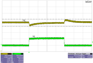

  • Hi Cedrick,
    I found a load transient scope shot for TPS7A25 with Vin = 10V, see below. You said the buzzer is taking about 160mA of current during the ON phase. I am seeing that the 3V3_BUZZ rail is drooping much more than I would expect since in this load transient shot of 0-200mA the output only droops by ~300mV. As I mentioned before, it would be nice to be able to see the LDO output current so we can see exactly what's going on.
    Nick
  • Hello Nick,
    Thank you for your continuous support.
    Kindly see the information provided by our customer below.
    "You're right, measuring current is needed - I was putting this off due to how immensely fiddly the mod would be, but I've bit the bullet!
    See attached plot - using a 0.5ohm resistor in the 3V3 buzzer LDO output path, measuring on either side with 2 scope probes and then using math functions to get current (M3 line).
    This shows a nice clean current rise. So still kind of confusing - the 3V3_BUZZ suddenly spikes upwards with no change in current, so I don't think it's a simple load transient. The best explanation I can think of is that the magnetic transducer armature suddenly reaches the end of its travel and back-drives 3V3_BUZZ so it rises sharply. Does this make sense to you?
    Maybe the LDO control loop then possibly overcompensates or does something strange and dips - but still not sure why it initially dips rather than rises? It looks like a voltage effect on the output rather than a normal current load transient (as both the input/output are stable during the initial current ramp).
    I'm also not sure why the 3V3_BUZZ doesn't recover to the full 3V3.
    I've also attached the same plot but run from a 12V lead acid battery instead, this suggests the second half of the ringing is a red herring and just due to the powersupply. However, the root issue is still there - the 12V dip and the magnitude is the same.
    Lastly, is there a Spice model available for this part?
    Thanks so much for your continued help! We're getting somewhere
    Cedrick
