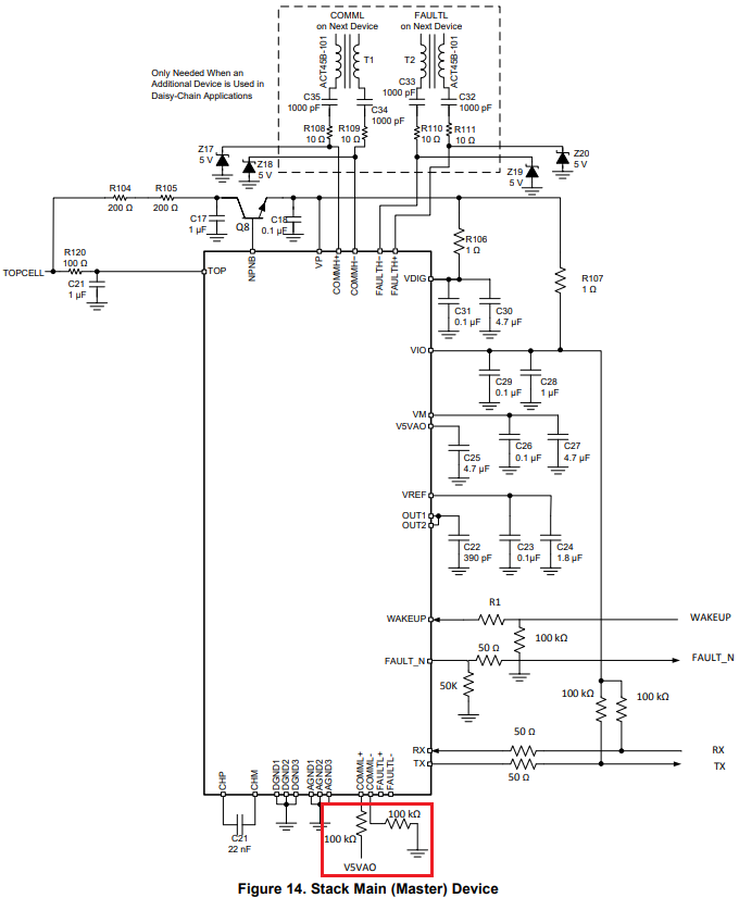

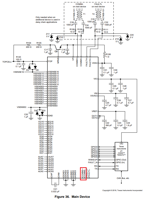

The datasheet Figure 36 shows the following and it seems to leave unconnected for COMML+/COMML-.
https://www.tij.co.jp/jp/lit/ds/symlink/bq76pl455a-q1.pdf
On the other hand, Figure 14 of SLUA791A shows the following and there are pull-up/pull-down for COMML+/COMML-.
Which is correct?
https://www.ti.com/lit/an/slua791a/slua791a.pdf
Yaita
  • Hi K.
    Technically, the COMML pins could be  left floating and  disabled in  software. However, best  practice is to include  the pull up/pull down and disable in S/W if not used.
    So both are technically correct, but following the design consideration document is preferred
