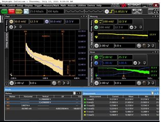

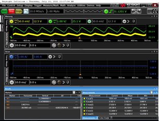

I hope you can give me some advice to the following Problem.

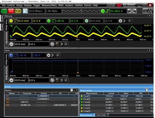

When I draw more Power from my power source it will produce a 100Hz Voltage ripple.
This increase in input ripple will be transferred to the output of the LM3150.
1A: Uout p-p = 0,070V (LC Ripple of LM3150 itself)
4A: Uin p-p=3,1V Uout = 0,100V
6A: Uin p-p=4,5V Uout = 0,135V
Is there a way to reduce the transfer of this ripple more?
Or is my only option to reduce the input ripple itself?
  • Hi Mario,
    I suspect increasing the converter switching frequency will help increase the input ripple rejection.
    However there will be some unavoidable AC-coupling due to capacitances of MOSFETs.
    It would be best to reduce the ripple of the input.
