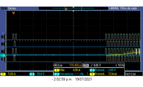

The problem is that the DC/DC converter output never stabilizes, when it starts, it gets to the desired voltage but immediately turns off. This sequence happens all time.
The following picture shows this operation.
The blue signal is the output voltage, the yellow signal is the input current. The white signals are the PWM.
Could you please tell me what could be happening and how to repair this fail?
  • Hi, Javier
    it looks UCC28950 enter burst mode.
    I think there is no Synchronous rectification on secondary side since the output voltage is high。
    You can try to decrease resistor on TMIN pin to 10kohm, which can make the burst mode threshold at minimal value.
    Yunsheng

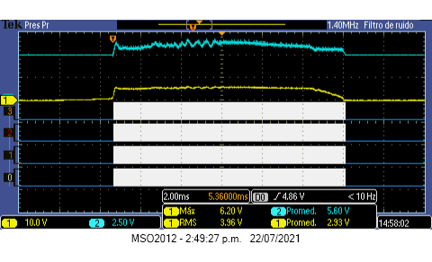

    You are right, I don't have Syncrhonous rectification on secundary side. I had the Tmin Resistor on 13 kOhm and I changed it to 10 kOhm but the response is similar. I am thinking that the problem could be the current sensor network. The following picture shows the input current (yellow signal) and of the sensor current signal (blue siignal). What do you thing about it?
    Thank you
  • Hi, Javier
    Could you help to zoom in the first 10 switching cycle when OUTX is enable? please capture the CS/OUTA/OUTB pin voltage and input current in the sane waveform.
    It is better to share the schematic, please help to get it.
    Yunsheng

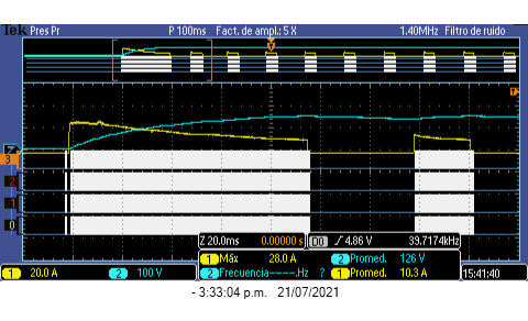

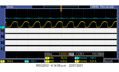

    We put the capacitor closer to the VREF and our response was better. The following are the picture of our new response.

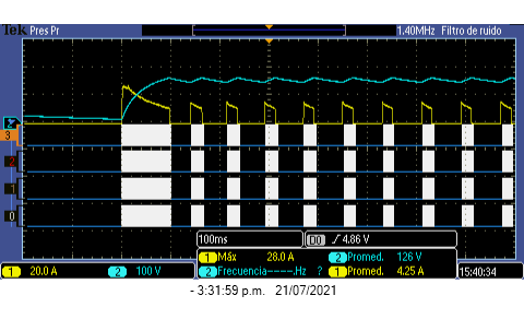

    The blue signal is the output voltage and the yellow signal is the output current. In this case, the PWM is not reb0oting but We don't understand why the current signal has this waveform and If we increase the load the DC-DC converter is rebooting again. The following picture shows it.

  • Javier
    first of all, you need to confirm VREF is stable at all the load condition, otherwise it is normal to see the system unstable.
    regarding to new response, if VREF is stable, then the loop compensation is need to optimized, it is better to test gain/phase curve of feedback loop.
    anther important point is the layout, it is recommended to use 4 layers for UCC28950 and place ground plane under UCC28950, it is not possible to make UCC28950 stable with two layers PCB.
    Yunsheng
