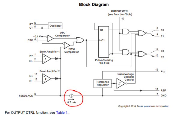

Hello guys,
One of my customers is considering using TL594.
They want to know the manufacturing variation distribution data of "FEEDBACK" input sink current (Min=0.3mA, Typ=0.7mA) as a histogram graph like Figure 3 graph on page 8 of REF5050 datasheet.
Do you have such data?
Could you please give me your reply?
Kazuya.
  • Hi Kazuya,
    We do not share the parametric distribution data beyond the MIN/TYP limits shown in the data sheet. Since the MIN value is 0.3 mA, it is recommended to limit the impedance seen by the FB pin such that <0.3 mA is allowed to sink into the FB pin.
    Steve M
