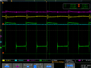

    I attached waveform for Vout and Switching current, please see below;
    I feel that 300mA and 600mA are not stable, too.
    ※ch1: Switching current (1A/div), ch2: Vout (10V/div), maybe switching current is connected opposite direction the current probe.
    ・0A ⇒ Vout: 23.5V, 10μs/div
    ・300mA ⇒ Vout: 23.5V, 10μs/div
    ・600mA ⇒ Vout: 23.5V, 10μs/div and 20μs/div
    ・800mA ⇒ Vout: 21.0V, 10μs/div and 20μs/div
    Additional information, I attached switching voltage.
    When start to high-side on timing occur ON/OFF switching.
    And I conscious that FET's gate charge is a little higher than recommend value, is these point have any impact?
    About layout, I look like feedback node is no problem because of small loop area.
    Now I confirming analog GND.
    Please let me know if you have any notices.

  • Hello Satoshi,
    Please check if slope compensation helps. This looks like subharmonic oscillation on the current which would mean slope compensation is needed.
    The loop area for the feedback is seldom a problem. The loop area for the power path and here especially the area transistor, inductor, diode, output capacitor, sense resistor is the most important loop as there are high changing currents.
