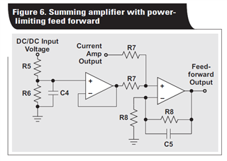

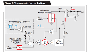

1.) Based on this figure, I know I need to detect the input power, but I do not understand why need to sum up with input voltage and input current.

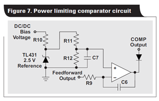

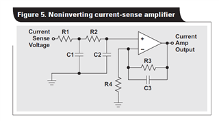

2.)  based on figure 5, 6, 7, how to design these capacitor and resistor values, can you offer me a design example file?

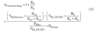

3.) How to derive equation 2 and equation 3, I am very confused about how to get this formula.
