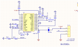

I am using the following circuit for charging but it takes much time to charge. Is there any resistor that can I change for FAST charging?
Please visit https://e2e.ti.com/support/power-management/f/power-management-forum/890624/faq-bq25601-i2c-controlled-bq2560x-schematic-review-and-pcb-layout-design-tips for I2C controlled BQ2560X: Schematic Review and PCB Layout Design Tips and https://e2e.ti.com/support/power-management/f/power-management-forum/990488/faq-bq25601-bq2560x-faqs for BQ2560x FAQs
