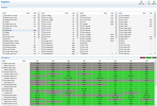

I use a BQ40Z50R1 fuel gage chip in my product. I see 2 issues with the SMBus communications with the gage.
1. The gage takes >1hr to come out of ship mode.
2. When it's out of ship mode, I can sense the pack voltage and can charge/discharge the pack without issues. But I cannot get BQ studio to connect to the gage. I have used the same setup to talk successfully to other gages without issues. So I know the hardware & connections are not the issue.
Please see the image below of the bit map and the registers I see of the packs that have the SMB issues.
I am using a EV-2400 module with Firmware version 0.28, and have BQ studio version 1.3.101.
The gages were communicating without issues prior to going into ship mode.
I am concluding that the BQ40Z50R1 gage might have SMBus communication issues when coming out of ship mode. Is that a known problem? If so, is there a way to reset the SMBus comms?
Pls let me know.
  • Hi Bhaskar,
