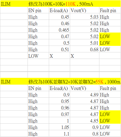

Dear Sir,
May I know what is /fault pin behavior?
Here is my customer test result and seems there is something wrong with /fault pin output.
My customer performs 500mA and 1A current limit test and found fault pin will output low even the output current did not reach the limit current.
May I know why?
Anything I misunderstand for the fault pin function?
Thanks.
  • Hi Sir,
    It has the current limit accuracy.
    Please see the datasheet Page 5  current limit section which includes the min and max value.
