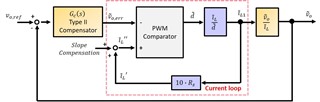

I tried to draw the Transfer Function Control Block Diagram of LM5122.
May you let me know if my understanding is correct or not?
In addition, may you let me know the transfer function of PWM comparator?
And for slope compensation, it may impact the loop gain response. May you let me know if  we could ignore slope compensation impact when we draw the bode plot? And why?
Thanks.
