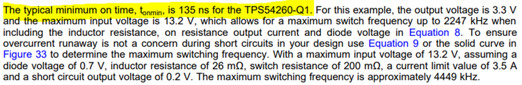

My customer is currently using the TPS54260-Q1 in one of their designs and had a quick question about the minimum on time tolerance of the device. We state that this is 135ns typical in the datasheet:
Do we happen to have a maximum tolerance spec for this that could be shared?

  • Hello
    Unfortunately, since the minimum on-time does not appear in the Electrical Characteristic table, we do not test that parameter and
    do not have data for the maximum value.
    You may want to look at a newer device for which we have full characterization data.
