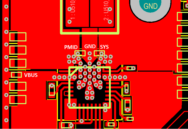

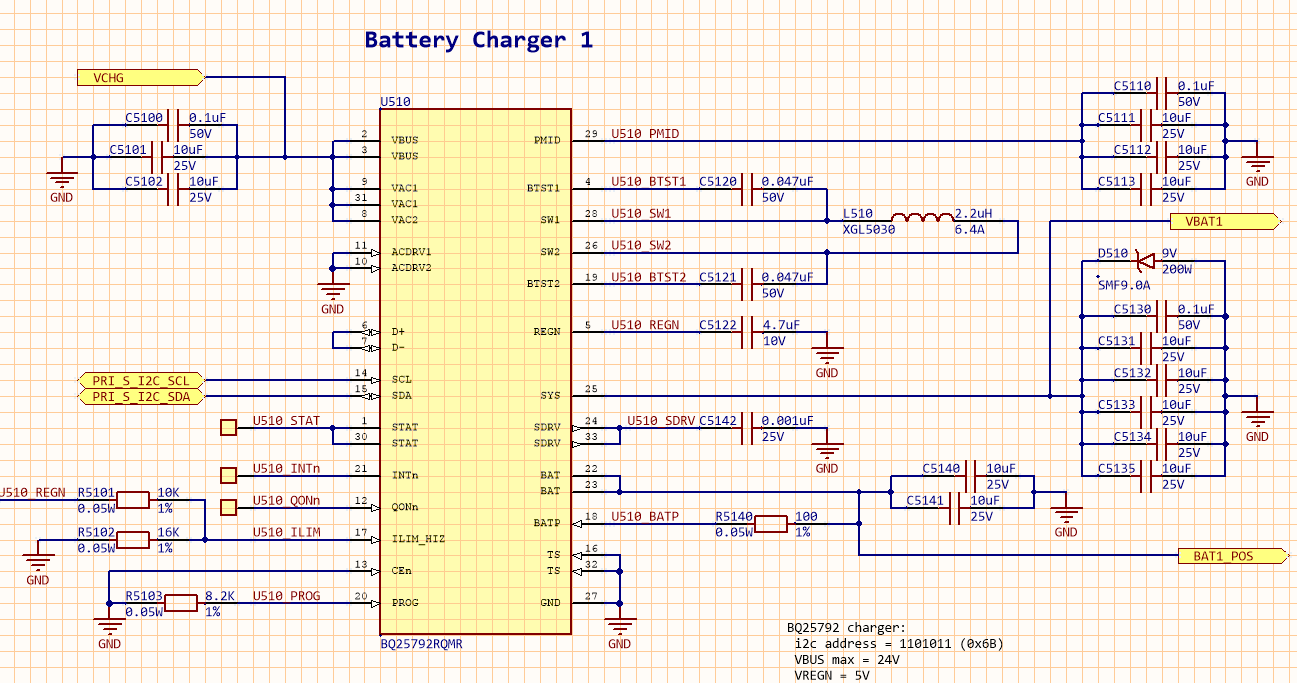

BQ25792: ADC IBAT and IBUS channels are intermittent during OTG operation.
Part Number: BQ25792
IBAT and/or IBUS periodically report incorrect values during OTG operation. The actual battery and VBUS currents are steady (measured outside the part) as are all the other reported ADC channels, and I don't see any faults or changes in other registers. The incorrect currents are either very low values, or half the normal value and opposite polarity, like this...
Normal: -1800 to -1900
Incorrect: -10 to +10, or +900 to +050
Below are register dumps in normal and false low current times, and also an i2c trace that looks fine in both cases.
