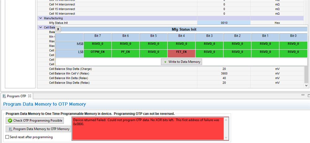

Dear TI team,
I have a problem with reprogram bit Settings:Manufacturing:Mfg Status Init[FET_EN] by BQStudio.
When I change value of Settings:Manufacturing:Mfg Status Init[FET_EN] and check if OTP program possible by click button "Check OTP Programming Possible", I always get an error
like "Device returned Failed:  Could not program OTP data. No XOR bits left.  This first address of failure was 0x0800."
I found that this error only occur when I change this bit, other bits or other registers are both check and reprogram OK.
Additional, I have reprogramed this bit, Settings:Manufacturing:Mfg Status Init[FET_EN], successfully several times before I get this error.
Please check atteched image
