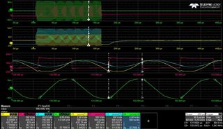

I'm trying to develop a 350W LLC using this controller.For various reasons we want to minimise the effective series primary inductance.
This means that there is even more of an issue with high primary circuit current in conditions where Vout is low (during startup & abnormal conditions).
I have a prototype which is showing around 18A peak primary current at startup (Vht = 380V, Vout = low, effective series inductance around 8~10uH, controller runs at ~590kHz)
18A peak is a bit scary for this application, but the controller is not pushing the frequency up to reduce it.
SS pin is low ~0.6V but the VCR pin is showing -0.9V to +7.4V peak-peak, and -0.6V / + 7.0V just before the switching points of the primary switches.
I don't understand why the controller is not commutating sooner, when VCR crosses (effectively) +/- V(SS pin), which I think is what it should be doing in these circumstances
The only explanation I can think of is the propagation delay from VCR crossing the Vth / Vtl thresholds to changing the gate drive (see sect 7.3.1 of the datasheet)
What is this propagation delay likely to be? Is it in the datasheet anywhere, I can't find it?
What are the practical (controller) limits to maximum operating frequency (I note minimum on-time is ~250ns)?
Notes:
cap from VCR to 0V is 2N7
power switches are GaN with very low gate charge, so they'll not be hard to drive fast
The trace shows a burst at low Vout, terminated by OCP2, I think
CH1 Yellow VCR pin of UCC2465404
CH2 Red HB out = TX term 1 in
CH3 blue V(Cres)
CH4 green Ipri
D0 violet HB gate L

    The maximum switching frequency after soft start of UCC25640X is not recommended to be higher than 350kHz, because:
    1. the thermal of UCC25640X is critical because loss of high side low side driver inside the IC
    2. if the switching frequency is high, the resonant current at turn off event of HO/LO is small, which could trigger ZCS protection.
    I would suggest you to decrease the pull down capacitor of VCR pin.
    The propagation delay from VCR crossing the Vth / Vtl thresholds to changing the gate drive is around 100ns.
    Yunsheng

    OK, it seems I am using the wrong part for this application because I do need to operate above 350kHz in some conditions.
    If you have any suggestions, I'd be grateful
    Paul
  • Hi, Paul
    I am sorry to let you know, there is no solution to support >350kHz LLC here.
    Yunsheng
