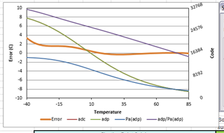

  • After manipulating the spreadsheet some, I think this is the default (i.e. uncalibrated) error.

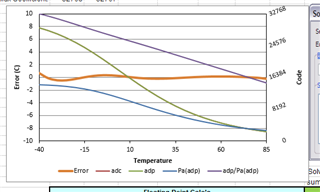

    If the gauge's calibration routine is run, I think the error can be reduced to the following.
    These are both nominal and don't account for error introduced by the NTC itself or these other variables within the gauge.
    • Reference voltage – both for the pull-up resistor and ADC (nominal is 1.8 V)
    • 15-bit resolution – minimum is 14 bits
    • Pull-up resistor tolerance – nominal is 18k
    • Pull-down resistor value – nothing is listed in the datasheet, but the spreadsheet had a very specific default value (that was left as-is)
    • Whatever the 'resistance drift over temperature' specification is
