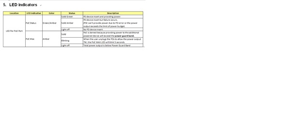

  • Hi Sir,
    may we know another request?
    does the internal register of TPS23861 can support the following LED indicator of D-LINK RFQ?
    if not, there any relevant design or suggestion cna provide to us?
  • Hi Tommy,
    The TPS23861 has wide range of interupts and status registers that can be read to accomodate these. I do recommend taking the TPS23861EVM and its GUI along with a PoE PD EVM up to Class 4 and putting the PSE EVM under these condition described in your table. Then you can see in the GUI how these registers change such that you will know which registers to monitor to set the logic of your LEDs.

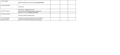

  • Hi Sir,
    the customer want to know whether TPS23861 can meet the requirement of attached file? thanks for your great help.
    i already confirm that some function can meet.
    複本 PoE SPEC UM_20210802.xlsx
  • Hi Tommy, i looked through the excel sheet and the open items are all either system level software implementations or system level hardware implementations. For the TPS23861, from a software prospective, the product page has very simple reference code for boot up, negotiation, and power up. So customer will need to make the system level software to do the power port management.
    The closest solution i recommend for a more complete system software PSE solution is using TPS23882 with firmPSE. FirmPSE is our GUI implemented system PSE software solution with power port management. This would be the best start for your customer. Note FirmPSE is not compatible with the older TPS23861.
