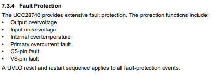

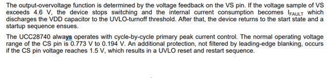

May I know the UCC28740 OVP and OCP fault protection method? Is auto-recovery or latch? thanks.
Hi, Rock
the OVP and OCP of ucc28740 is kind of auto recovery, OVP/OCP will stop switching and leads to VCC UVLO and restart.
