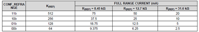

1. In datasheet, does it mean we could adjust the maximum output current by setting different resistor values? If I would like to achieve a 64mA current, I could only set CONF_REFRANGE 11b and using R=8.45kohm then dimming from 75 to 64? Any other method could I use?

    1 Yes, CONF_REFRANGE=11b and Rref=8.45kohm is the only choose for you to achieve 64mA.
