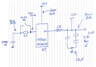

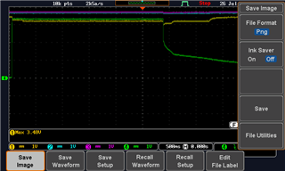

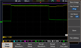

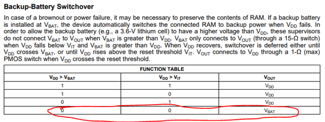

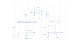

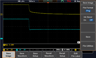

Hi

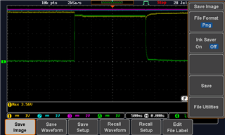

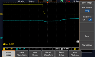

I have a circuit which uses the TPS3620 and has a 220uF capacitor on VOUT. When VDD is removed there is about 0.5 second delay before the TPS3620 switches over to VBAT. Therefore could this be caused by current flowing from the 220uF capacitor into VDD and keeping this supply voltage up until the cap discharges below VIT. When this happens the TPS3620 then switches over to VBAT?
We are thinking of putting a diode in series with between VOUT and the 220uF capacitor but it is not an ideal solution.
Br
Edward
